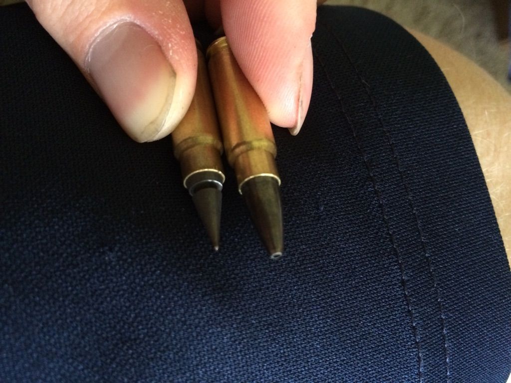

Just got my first bit of EA ammo and thought I would share some thoughts.
All the boxes came sealed, the S4M in a 50 rnd plastic box, the T6B in a 25 rnd cardboard box.
S4M: Moly Coated Aluminum Core HP Cartridge 28gr
Pros:
Detented primer at 6 points, presumably to hold higher pressures**
Bullet Moly Coating
Little to no case scratching from bullet pulling
Cons:
Plastic box was too large, rounds shake and damage each other
Some bullet coating was scraped off from adjacent rounds
Suggestions:
Use smaller, OE dimension box to prevent movement or newer 25rnd cardboard box
T6B: Segmented Copper Bullet 28gr
Pros:
Bullet Design is very intriguing, boat tail-esque, segmented, sharp tip
Bullet Anodized
Box holds rounds safely
Cons:
Brass scratched from pulling bullets
No detents on the primer as compared to the S4M
Box is excessively large for the small amount of bullets (~4 times OE box size with half the cartridges)
Suggestions:
Bring back the detents, unless it has negative consequences
A smaller box, or larger capacity would be a good idea, OE boxes keep the bullets safe.
(T6B Left, S4M Right)
Questions for EA:
1. Can higher pressures/fps be achieved with the primer detents?
(S4M Left, T6B Right)
2. Is there any plans for a tracer round for the 5.7? It would be fitting for the large capacity these mags carry, and high accuracy they produce. (I just heard from another member, that "Illuminator" was a thing previously before my time here. Will we see them again?)
3. Will there be full boat-tail design?
4. Further plans with the segmented bullet design?
Info: http://iaaforum.org/forum3/viewtopic.php?f=8&t=16450" onclick="window.open(this.href);return false;
5. Can a heavier bullet be used on the subsonics to maintain high energy while keeping the speed down?
6. Have you encountered any issues with rapid firing either round, or feed problems when using a staggered magazine?
7. Do you plan on increasing production quantities seeing as how much the demands exceed the supply. (Company growth?) Price could go down and availability to go up, resulting in more sales and larger margins, and help solidify your company in the market.

Questions for EA:
If you mean primer crimping? It is a requirement for Mil Spec ammo to have crimped primers. This has to do with full auto actions, how they cycle and keeping primers from popping out. Crimped primers can but NOT always mean that the round can handle higher pressure.
No. For awhile we offered them using mil surp plastic disk sealed 55gr immediate igniting tracers. Those are pretty much all gone and if you can find them the compound has broken down and 1 out 10 will light. There are new/mil surp but they are 62gr since the military has switched over to heavier bullets. There are after market 55gr tracers but they are from the Armscor, have a copper disk sealer and are designed to ignite AFTER 100 yards.
Of what? Both the T6B and S4M are boatail.
No since I have arrived at the best overall version, so good vangaurd is stealing the design and having an old contractor of ours GS Bullets illegally manufacture them.
50gr is perfect otherwise stability issues including baffle strikes occur.
HUH? all 5.7 mags are staggered. P90's have no issues with our ammo.
You do know the limiting factor has been no commercial source for brass? Also that we have spent the last 2 years and a Millions dollars invested into making our own in house EA brass with internal improvements using this press? Brass that is entering production stream now?
Notes:
I would like to add pictures if anyone would recommend a hosting site or a way upload to this site directly.
Edit: a Member helped me out, haven't used photobucket in years.. Thanks
Also looking to send in my FiveseveN for the Accurizing procedure, along with the spring, trigger, night sights, and threaded barrel, I'll give you a call soon, or you contact me anytime.
Keep it up with the Subsonic rounds, that is very cool, and will be purchasing some when/if I can get the barrel and suppressor,
Looking forward to the E-Blast function and the Coffee talks, got to the end of the videos and started watching Beer reviews and Aikido,
Thanks[/quote]
Toaster
Posts: 51
Joined: 09 Jun 2016, 20:06
Re: EA S4M and T6B First Impressions
Post by Toaster » 23 Jun 2016, 11:26
panzermk2 wrote:OK
Hopefully I don't miss anything.
:thumb:
Questions for EA:
I'm a mechanic, wrong lingo, but I'll remember it. We use it to keep bearings from walking out when loaded back and forth.
Good to know. Looked more resilient, and I understand how each process repeated several thousand times can add up quick. It looked like a good idea to me.
Bummer, any plans for a custom design? Seems like it could be a worthwhile endeavor. Haven't lost hope, yet.
Didn't realize the S4M was, good to know. Hadn't seen it outside the case yet, I looked it up and found some better pics.
Don't worry, we know yours is best. ;) I was just curious. Keep yours in production for a good while longer.
Ouch, thats no good. Glad you've tested it, again, curiosity.
Perhaps staggered was the wrong term. I meant like S4M/T6B/S4M/T6B loading. As well as rapid fire the hotter EA ammo.
I did not know that the brass itself was the limiting factor, but that you were just a small operation. However I did know that it was less than optimal and have been keeping up with the Brass news. I've heard comparisons with the 300 AAC and hope to see a similar journey for you. I'm really happy and wish you the best of luck, I'll be making an order here shortly.
Thanks for your time.
